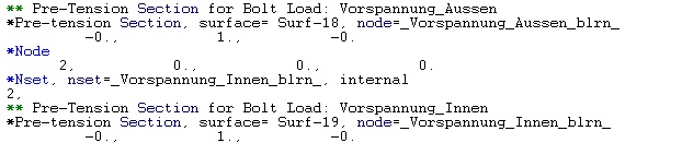

We are currently trying to reproduce a scenario used in Abaqus/CAE in 3DExperience with Mechanical Scenario Creation.
The scenario is the following: In Abaqus we have an Axisymmetric model which has a Pre-Tension for Bolt Load as load.
It seems not possible to create the same in 3DExperience. Whenever we use a Axisymmetric model, any load regarding pre-tensioning or pre-loading is greyed out and not possible to select.
Is there a way in 3DExperience to create an Axisymmetric model and use it with Pre-Tensions?
In the screenshot you see the definiton in CAE we want to build in 3DExperience.
