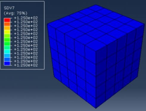

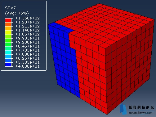

I found the number of material points (namely, nblock) varied! First time I ran this loop, I got the contour of state variable 7 (SDV7) shown below. The SDV7 were various. But from the subroutine they were supposed to be same.
Then I coarsen the mesh, and get a different result, SDV7 of every element were same (equal to the material point number=125)! Shown below:
Then I substituted coordMp(1,1) for nblock in the above-mentioned loop, and found similar phenomenon.
I wonder if the number of material points and their coordinates will vary in a loop? Those results are beyond my expectation.
