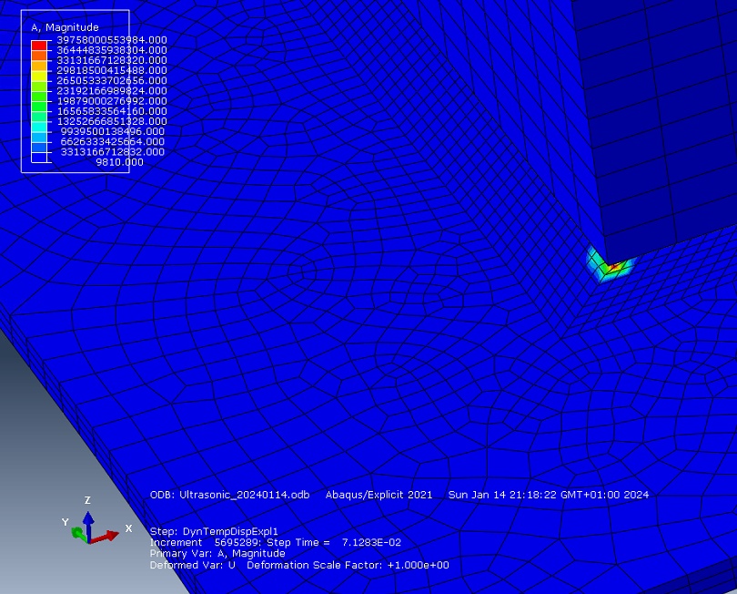

Usually my simulation runs smoothly and does what it's supposed to do, but after long calculation times, e.g. after 5.7 Million steps in my lastest simulation, suddenly one element, that is both involved in contact and that has the viscoelastic material, suddenly collapses and the simulation is stopped due to excessive element distortion .

Screenshot showing acceleration of the crashing element (Element inverts / collapses)

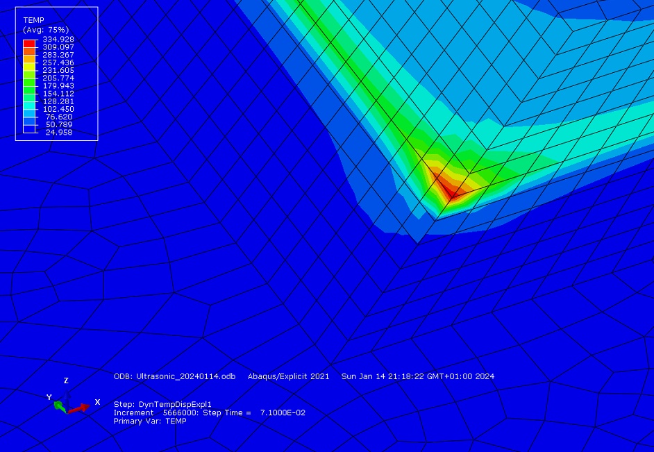

Screenshots showing Sharp temperature gradient at the failing element (probably a singularity or something like that).

My Conclusion:  The elements crashing are always at Edges and mostly on corners of parts that are in contact with other parts, which makes me think that there is some sort of material instability. As the models runs well for milltions of increments and then suddenly crashes, it has to do with the temperature locally changing over the course of the simulation. If I artificially heat up the material homogenous to the temperatures where the material tends to crash, this doesn't lead to any sort of crashing (on short simulations). I assume that crashing in my case may also have to do with a sharp gradient of material properties... If the temperature dependent gradient in viscoelastic (TTS) material properties seems to be the problem for the material instability, do you have any recommendation on how to fix this? I am working on this for many months now, and I can't find a solution to my problem. As usually a single element is collapsing to zero volume, I assumed that quadratic bulk viscosity damping may be the solution, as it smears shock fronts, but it also doesnt seem to help, as elements crash, whatsoever.
