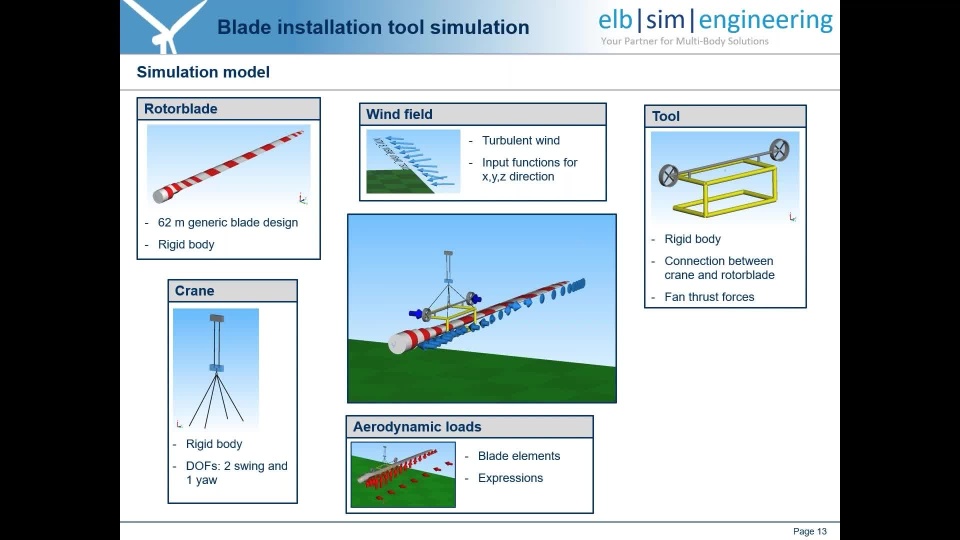

The first part of the presentation describes how a load calculation process with Simpack can be developed and easily integrated into already existing company-specific workflows.

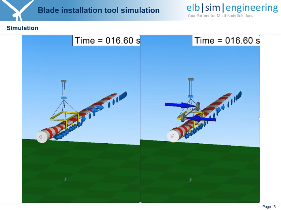

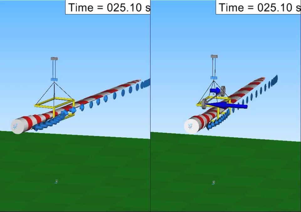

Recently, a device has been used for blade assembly that can hold and position the rotor blade independently and stably without the support of taglines. Especially on construction sites where limited space leads to a significantly easier and faster assembly of the rotor blades.
For new and larger blade designs, the question arises in advance of which wind conditions the device can still hold the rotor blade in a stable position.
The model setup, simulations, definition of load cases and the result post-processing will be shown to answer this question.
