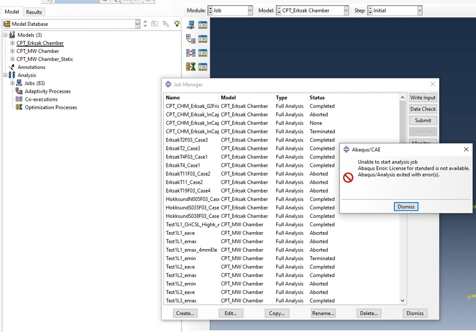

Hello all,
I am switching my abaqus license from flexnet to DSLS. I created DSLS.txt file and changed abaqus_v6 and custom_v6 to read this file. Now I am able to open CAE but cannot submit jobs to run simulations. It says the license is not available. Is there anything else I need to change? We are sharing the license with other research groups. I contact with them. The professor said if I can connect to CAE I should be able to submit the job, and I need to check my own configuration files. Thanks!
Cheers,
Xingyi.
