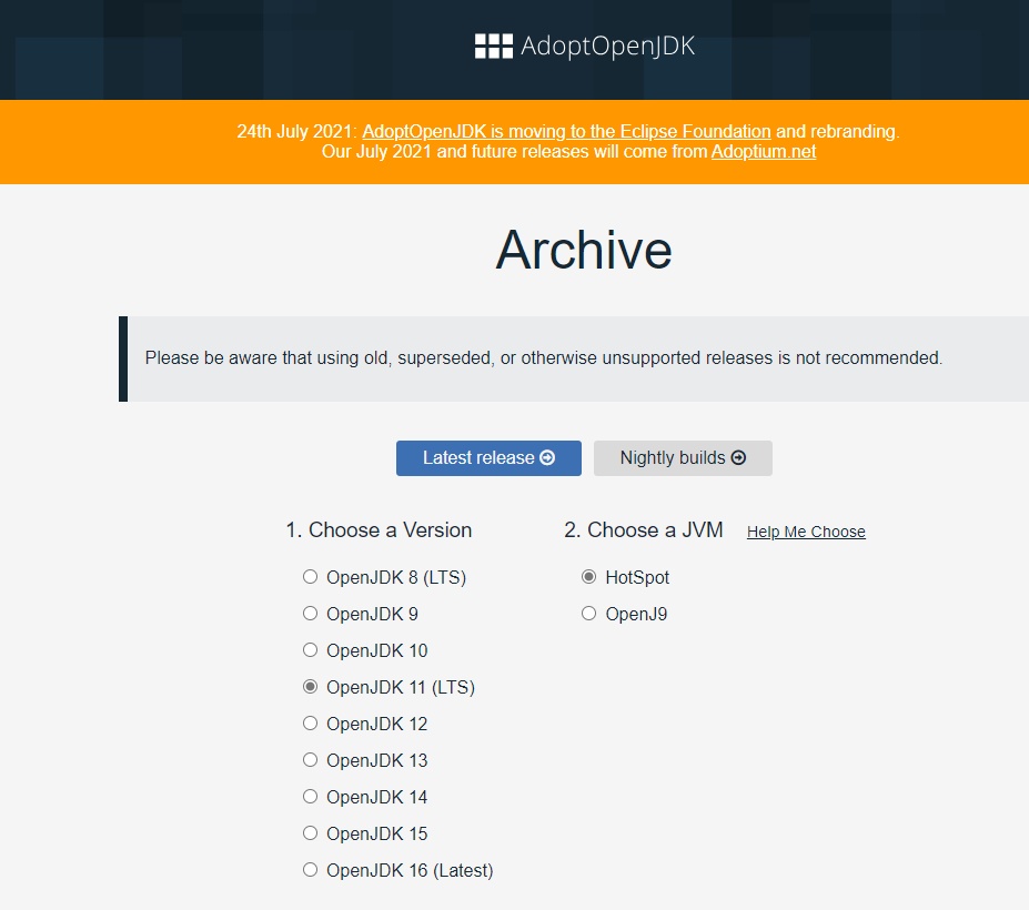

The dilemma here is that SIMULIA installer recognizes only Oracle and AdoptOpenJDK as trusted provider, however, AdoptOpenJDK has publically announced on their website that all future version i.e. from 17 onwards will be uploaded at Adoptium website.

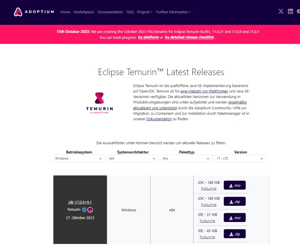

Since I didn't have Java installed on my machine, I looked for openjdk and downloaded the required version from successor of AdoptOpenJDK namely Adoptium Eclipse Temurin which was not recognized as official and the installation could not be proceeded.
