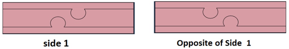

Is it possible to generate similar mesh on non-identical opposite faces?
I tried with the idea shared on the post https://r1132100503382-eu1-3dswym.3dexperience.3ds.com/#community:39/iquestion:sPeG__RdRv6B_TK1jV8jyA
But it is not working for this geometry. If the opposite (node-node) side meshes are not similar, then my plugin will not work to create the periodic boundary conditions. Any suggestions?
