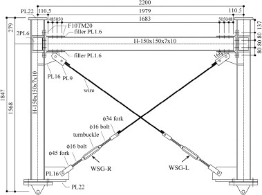

Hi! I am doing some analysis trials something similar with the attached model in which the beam frame is braced by wires/ropes. The analysis is facing converging problem from the start if I use the wire with truss element, but works fine with beam elements. Any ideas or suggestions would be highly appreciated. It is a static analysis, I am not sure if it is happening due to the large displacement analysis. I just simply rotational joints. Thank you!
