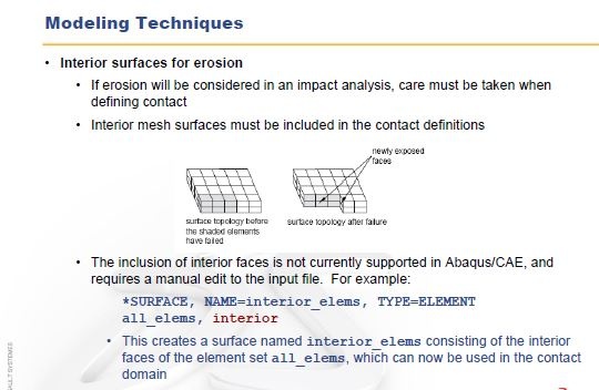

impact of a projectile on composite using uniFiber VUMAT.
I have come across this slide. which Abaqus version is the slide talking about?
Does Abaqus 6.19 capable of taking interior elements for erosion.
In which Abaqus version, the capability is added?
