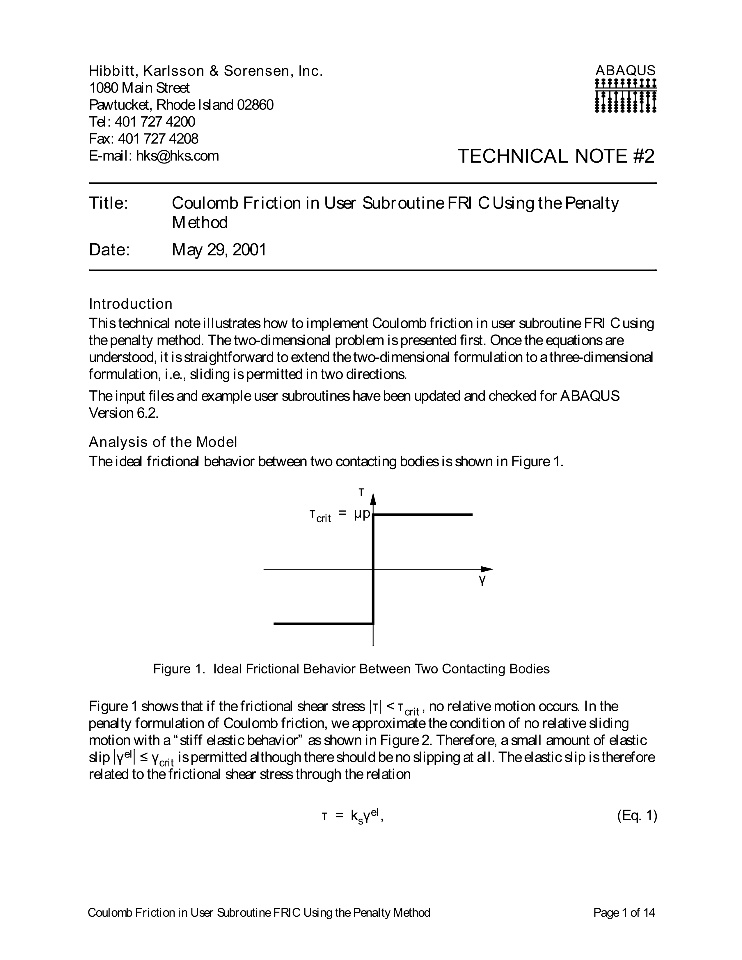

I found a technical document containing information on how to create  isotropic coulomb friction model using  user subroutine FRIC.
I tried to modify this model to anisotropic friction model with help of "abaqus theory manaual - coulomb friction - anisotoropic friction"
attached picture shows strain energy achieved from technical document input file, using embedded anisotropic model in abaqus instead of FRIC (friction coefficient 0.3 , 1, elastic slip 0.005 ).

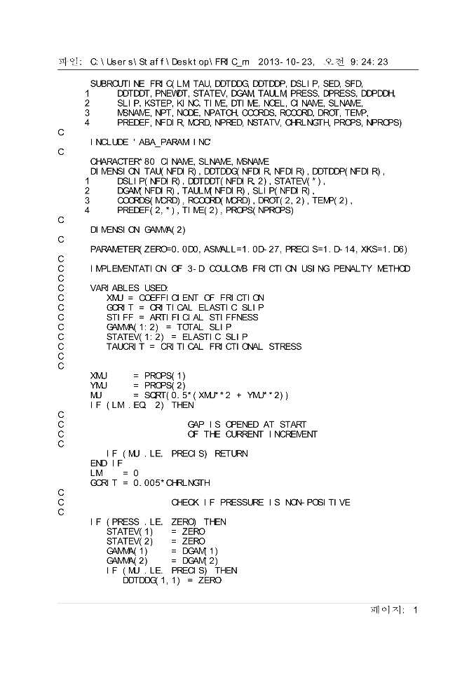

I tried to achieve same result with modified code but my result is not even close.
I'm attaching HSK technical document , there are input script for abaqus and code for 3D isotropic coulomb friction.
I'm also attaching code that i have modified.
