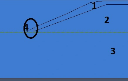

In my current Abaqus/Explicit CEL model, I have three analysis steps with different material‐behavior requirements across several regions, and I would appreciate your guidance on the best way to implement the third step.
  • Step 1: I apply gravity using the peak-strength material properties, and the slope remains stable.
  • Step 2: I reduce the material strength only in Region 4 (using a field variable), which causes that region to fail as intended.
  • Step 3: My objective is to update the material properties in other regions—particularly Region 2—based on the plastic strains that develop after Region 4 has failed. In other words, I want the accumulated plastic strain generated in Step 2 to control the evolution of material parameters in Step 3.
