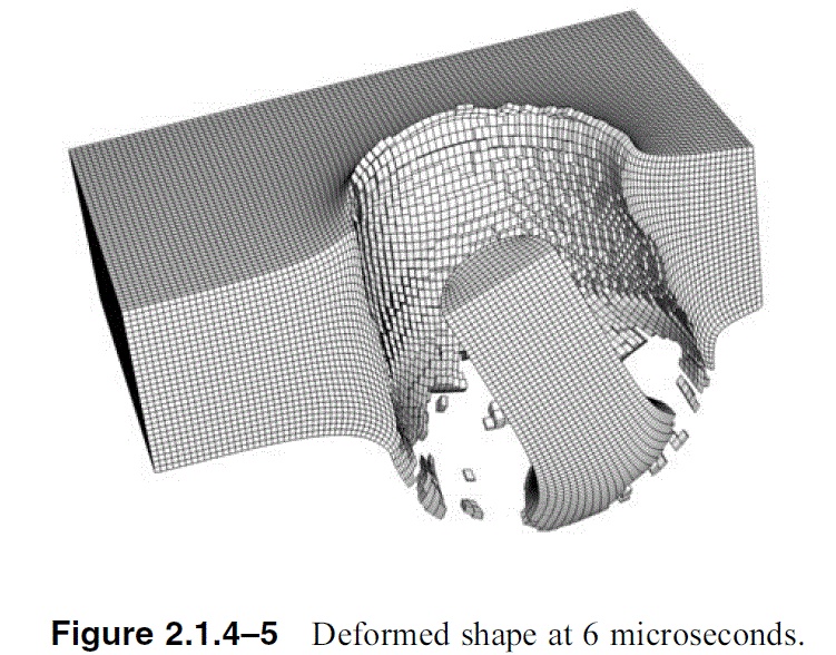

In order to get more familiar with ABAQUS Explicit, I want to reproduce a simulation from the ABAQUS 6.10 documentation (Example Problems Manual, Volume I: Static and Dynamic Analyses, 2.1.4 ERODING PROJECTILE IMPACTING ERODING PLATE). In this example, a high speed, cylindrical projectile hits a plate (same material) at an initial speed of 2000 m/s and elements from both bodies fail and are removed from the material:

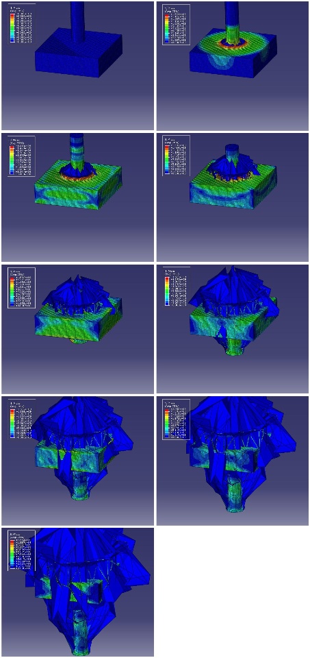

When I try to reproduce the simulation with a similar geometry and identical material properties, I get the following results:
The problem is, that in my simulation, no elements are being separated (no erosion of elements) but they all seem to stick together and are being extremely deformed/distorted.
Here's some general information about what I did and which settings I chose:
- Geometry is the same as in the ABAQUS documentation example. In my case the projectile hits the plate perpendicular (20° in the documentation). 2 bodies, PLATE and PROJECTILE.
- I copied the material properties. (import of the example .inp-file and then copy-paste of the material tables - in the ABAQUS user interface, not in a text program). These copied material properties include the following failure properties: Ductile damage, Damage evolution: Fracture energy = 500. Shear damage, Damage evolution: Fracture energy = 500.
- Boundary condition: PLATE is pinned like in the example.
- PROJECTILE has initial velocity of 2000 m/s like in the example.
- I created two surfaces for both bodies, mesh type surfaces, including the interior of the bodies.
- Interaction: General contact (explicit), contact domain: 4 surface pairs (projectile with plate, all with self, projectile with self, plate with self). I'm not sure, but I guess all with self and projectile with plate would suffice.

Could somebody please help me out or tell me what might be the problem why I am getting such huge element deformations and not the expected element erosion ?
