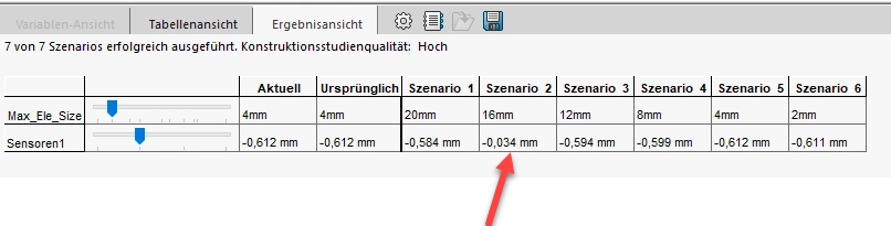

I wanted to carry out a mesh independence study on a model in SOLIDWORKS Simulation. By keeping all the boundary conditions same, I started with a coarse mesh and gradually reduced the element size to reach a very fine level.
I observed that the displacement values at a given location started to converge but for a particular element size, the values were totally out of the range (less than the expected result). Also the results were different, every time I re-run the study. At the first glance, I could not justify the results.
One probable explanation would be that the elements were behaving abnormally "stiffer" than other cases.
