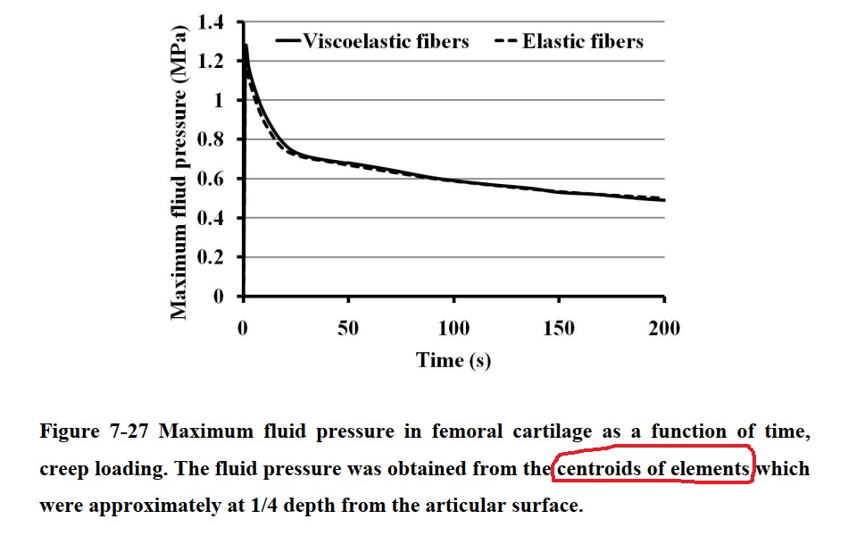

I am studying analysis of soil consolidation to fluid pressure in tissue. I would like to get a similar plot with the figure follows (the fıgure adopted from literature [1]).

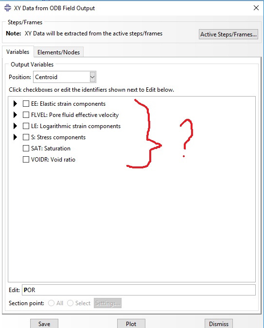

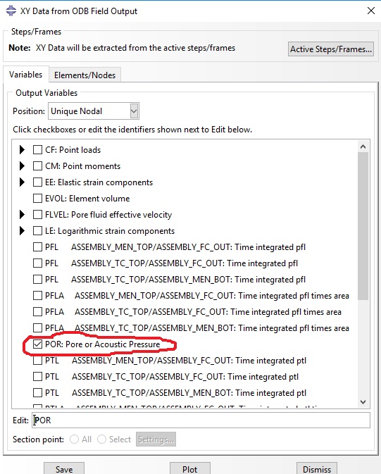

I mean that how can I obtain max. fluid pressure in any tissue of my model as a function time. I believe that output variable named "POR" represent fluid pressure. The issue that if I select "Unique Nodal" as follows picture, I can pick POR variable. But, when I select centroid as position, I can not see POR variable to click. But however, It writes in the literature that max fluid pressure was obtained from the centroids of elements which were approximately at 1/4 depth from the articular surface. (please see relevant figure in below)
How is that possible?
1) Kazemi, M., & Li, L. P. (2014). A viscoelastic poromechanical model of the knee joint in large compression. Medical engineering & physics, 36(8), 998-1006.
