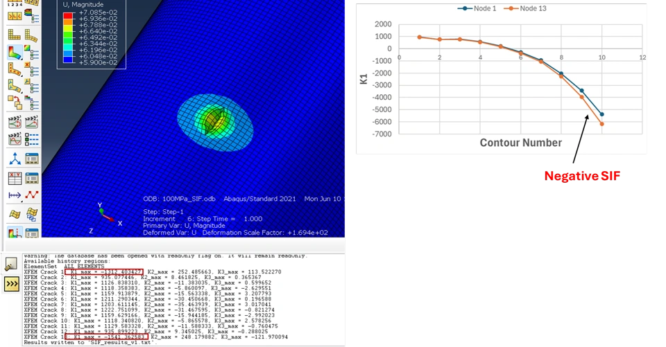

How to collect crack tip coordinates in XFEM?
I modeled an XFEM semicircular crack in a cylindrical pipe with internal pressure. I collected the SIF values for all nodes along the crack front. Surprisingly, for the first and last nodes, the SIF value tends to be negative values as the contour number increases. What could be the potential issue? Also, how can I extract the coordinates of the nodes along the crack front?
