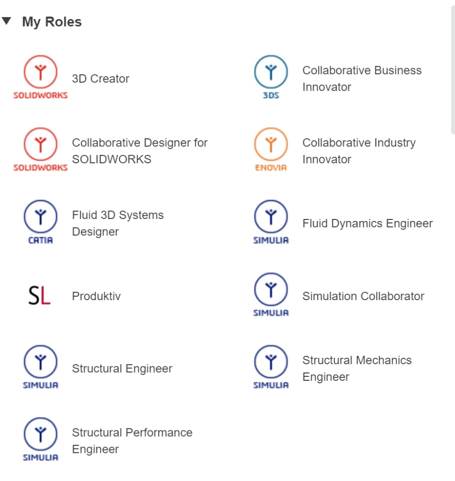

The question is, I do not see the Process Studio App in my 3DCompass. Which role is required to access this app? I have attached a screeshot of my roles.
