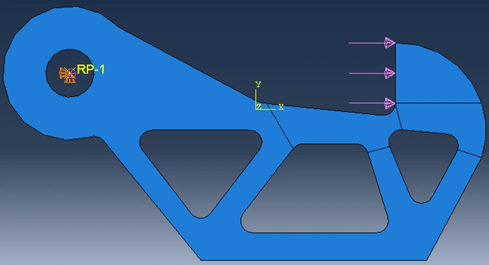

That is the setup:

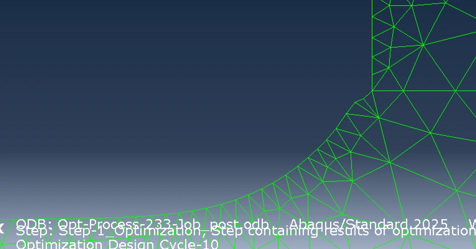

The optimization result is this

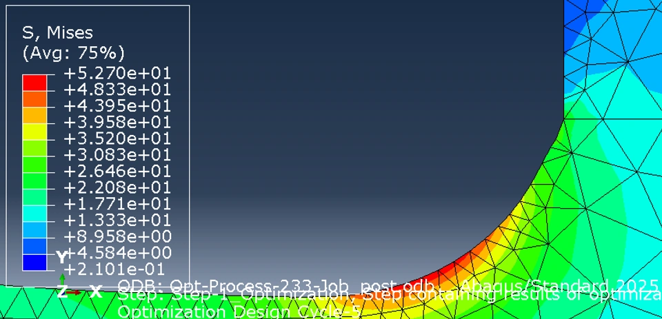

Clearly creating an artificial stress concentration (singularity, really, due to the sharp corner).
Cycle 5 actually produces a reasonable 15% reduction of max vm stress.
