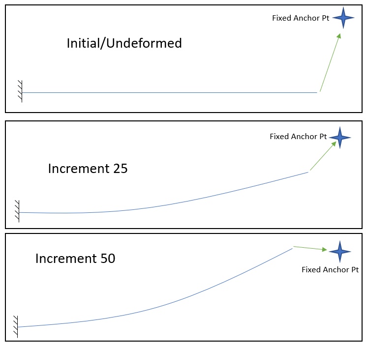

I am working with a geometrically nonlinear simulation, and I'm trying to have a nodal force consistently point at a fixed anchor point, as the model deflects. Using the default CF options doesn't achieve this, as the force consistently points in the same direction, and doesn't change to point towards the fixed anchor point as the model deflects. Using *FOLLOWER also doesn't achieve this, as the nodal rotation of the loaded node doesn't result in the force pointing at the same anchor point. Any ideas?
