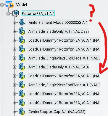

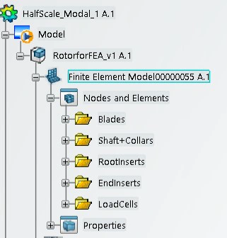

1: I have created user sets (see picture attached) to keep track of the FEA representations of the components in the assembly, since there are many components. However, I have not figured out any way to group the Shapes (physical products/3DShapes) themselves, which makes sorting through the shapes as I create contact sets tedious. Is there a work-around for this to similarly group shapes as I have for FEA representations, to help with manual contact set generation?
