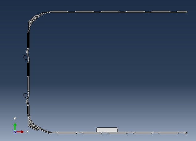

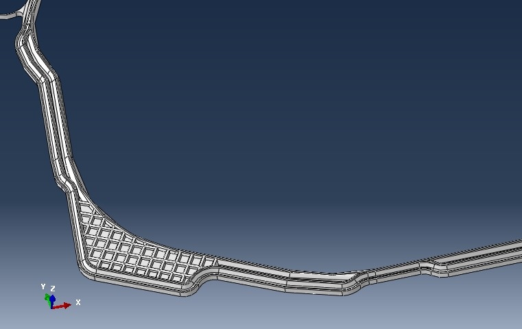

I'm having 3D cad data of gasket, pressure-overclosure curve material property, want to use gasket elements. But to use gasket elements we have to do hexa meshing which is not possible on gasket component. Tried to do partitions, virtual topology etc., but unable to create a hexa mesh. Later after doing some literature survey understood that we have to use continuum elements but to use these we should have hyperelastic data which is not available. For your reference attaching gasket pic
