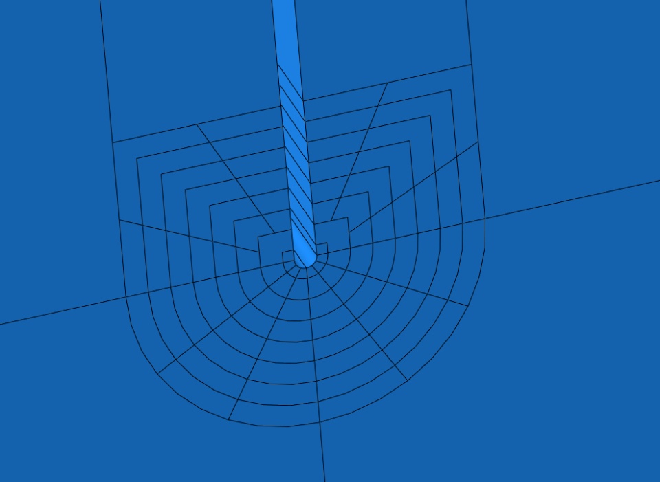

Hello All,
I am running a fracture analysis using a 3D model. I am using the countour integrals method. I have my crack front and crack line define and my normal vectors.
The analysis runs for TYPE=J, which is the default analysis.
But it fails when I switch the type to TYPE=K FACTORS with the following error:
abaqus ***ERROR: THE ELASTIC PROPERTIES HAVE NOT BEEN EXTRACTED SUCCESSFULLY FOR THE CONTOUR INTEGRAL CALCULATION OF K FACTORS. THE OPTIONAL PARAMETER "SYMM" MIGHT BE MISSING
Has anyone experienced this before?
Any advice is very much appreciated.
Thanks.
