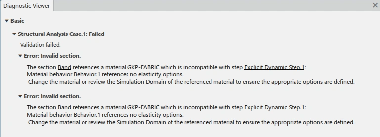

I'm unable to launch the simulation on 3DX as validation fails with the information below, the material is incompatible with the step.

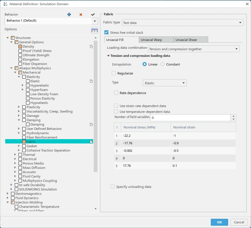

However the material is Fabric:

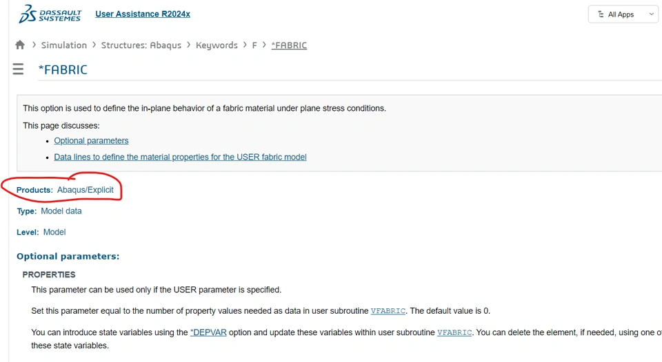

And *FABRIC is for explicit:
