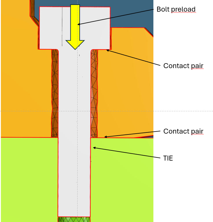

I have a question about modeling checks on bolts joints.
I modeled a 3d solid bolt and its joint appling the following "iteraction":
  • Contact pair between bolt head and plate 1
  • contact pair between plate 1 and 2
  • Tie on plate 2 and bolt thread.
Additionally, in my model there are:
  • a pretension load (known)
  • an external load (that for some reason, let's suppose I don't know)
How can I know the external load acting on my assembly (bolt + plates)? What output should I ask for and check?
