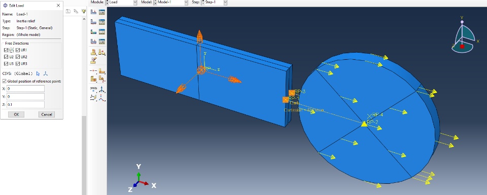

Hello,
I have created a simple model with the purpose of understanding how connectors and Inertia relief work.
My aim for the model is to simply attach 2 parts together with some elastic wire, apply a load on one of the parts and then see how the deformations take place when no boundary conditions are present.

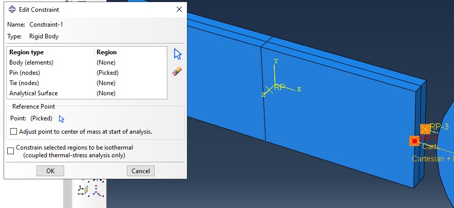

For connectors: I create 4 reference points on the assembly and then constrain the reference point to the vertice that they are adjacent to with "Pin" type. I then create 2 wires between the reference points and assign them a section of "Cartesian + Rotatation", so that all CORM are available and I give them some values for the stiffness.

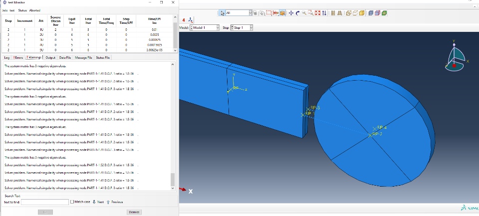

In my model I then create an Inertia relief load to balance out another body force load but I seem to have some errors and the simulation quickly aborts. I have attached some pictures for reference. Unfortunately it seems I am not able to attach the CAE or INP files here though.
Any help is greatly appreciated.
