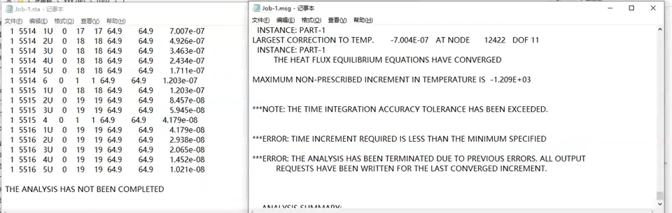

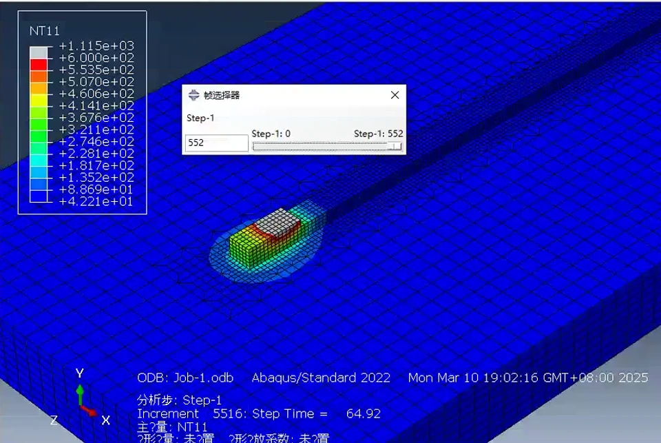

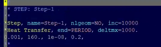

Hello, I utilized Abaqus to simulate the temperature field during the 3D printing process. The first two layers exhibited consistent results; however, an error occurred in the third layer: "Error: Time increment required is less than the minimum specified." Could you please provide any recommendations for resolving this issue?
