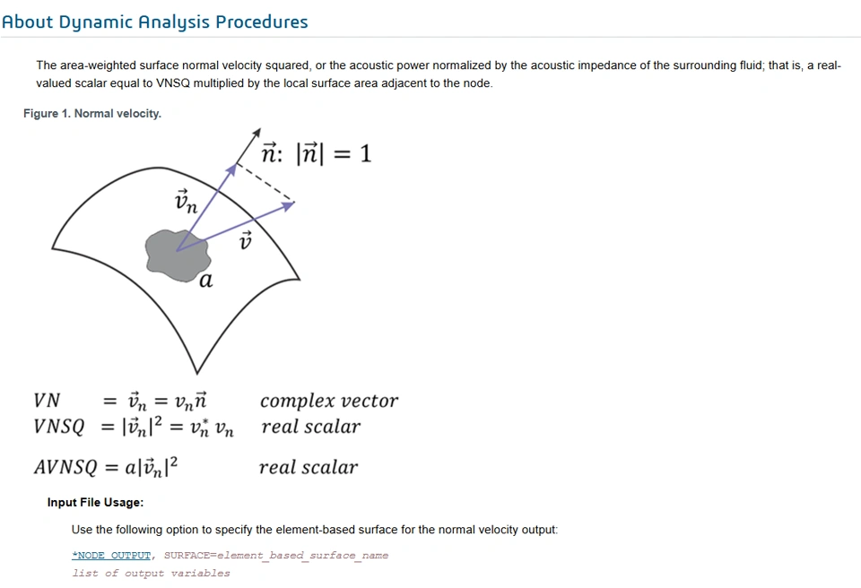

I'm currently working with an Abaqus Standard 3D (version 2022) model where I need to output the surface normal velocity (VN) for nodes associated with a specific element-based surface for a SSD step. I attempted to request this output using the *NODE OUTPUT command with a SURFACE parameter as mentioned in the abaqus manual here: but I encountered an error stating "unknown parameter surface".

*NODE OUTPUT, SURFACE = str_acou
VN
Could anyone help clarify the correct approach to specify node output for an element-based surface in Abaqus?
