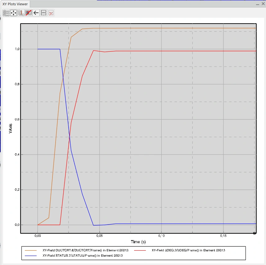

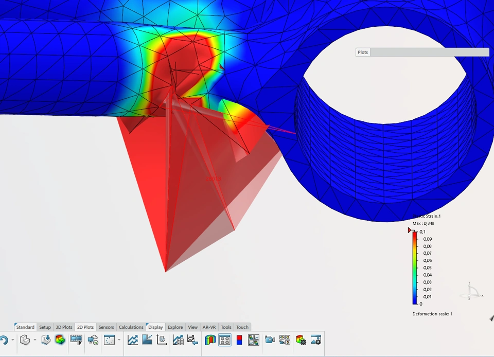

I'm currently trying to remove the failed elements from the post-processing results. Some elements are showing extreme distortion due to failure (as seen when checking STATUS, SDEG, and DUCTRT—please refer to the attached image for reference).
I'm currently using Johnson Cook damage model and Ductile damage with damage evolution defined on both and multiplicative degradation set.
I've searched through the community and online, but I haven’t been able to find an option or checkbox that allows me to exclude these failed elements from the results.
