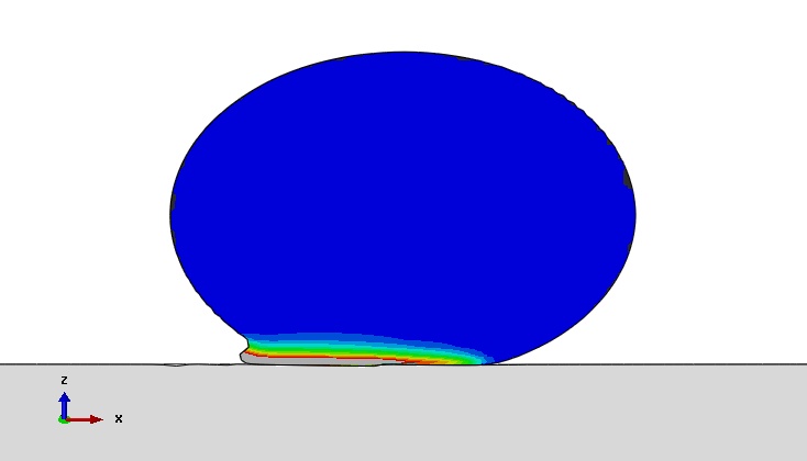

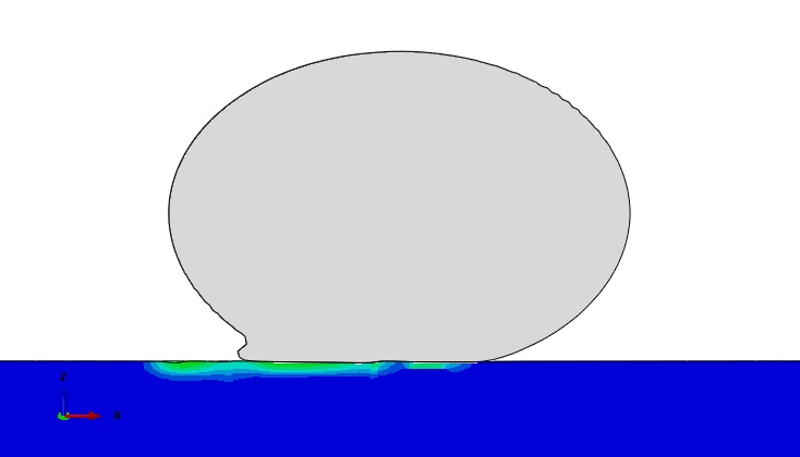

Hello everyone,
I'm currently working on conducting coupled Eulerian-Lagrangian simulations in Abaqus Explicit, specifically focusing on a spherical particle impacting the substrate. While I can generate temperature contour plots for the Eulerian and Lagrangian parts individually, I'm facing a challenge in displaying both sets of plots simultaneously. Is there a method or workaround to showcase temperature contour plots for both the Lagrangian and Eulerian components concurrently?
Thank you for your assistance!
