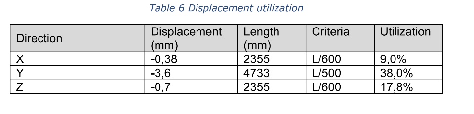

I am currently engaged in a static study simulation of a steel walkway platform. Upon reviewing the displacement results, I have encountered a challenge in locating a setting that allows me to display the displacement in specific directions and coordinates. By default, the results indicate a translational direction denoted as U. However, my objective is to precisely visualize the displacement of the steel structure in the Z-direction, X-direction, and Y-direction individually. Please refer to Picture 2 for an illustration of the desired result.
This nuanced data is important for follow the Design Code - Eurocode 3, particularly for compliance with regulations governing working platforms.
