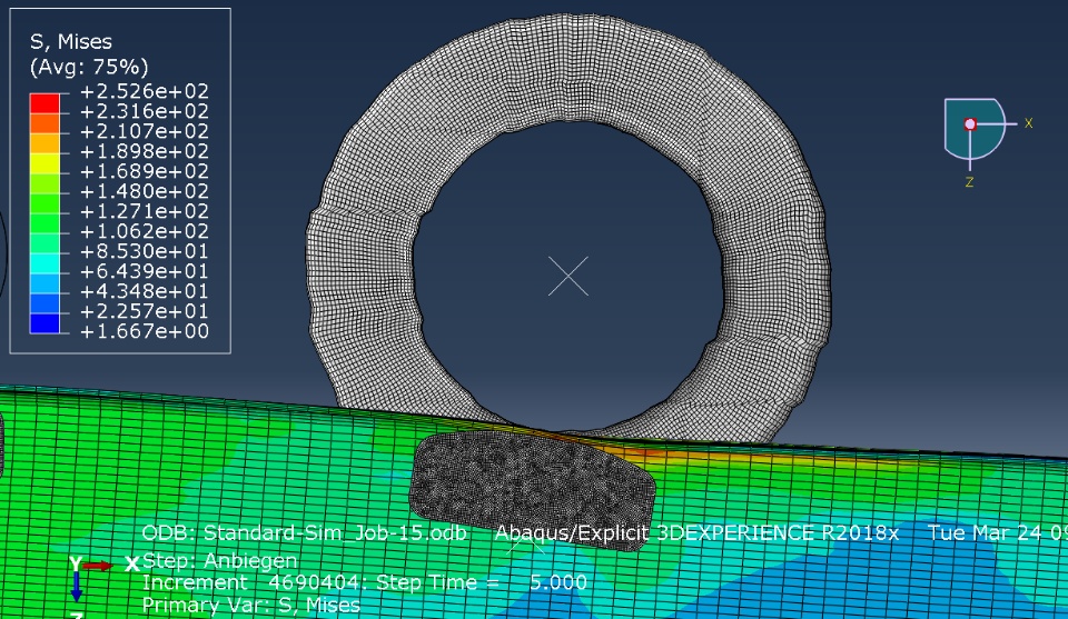

I have a problem with Abaqus that I can't really get into. Maybe you can help me there. I did a forming simulation with Abaqus on the computing cluster of our university. One of the tools, which was actually defined as a rigid body, was deformed during the simulation (see picture in the appendix). The tool was modeled as a rigid body of the type "Discrete rigid". The strange thing is that I can't observe this behaviour when I run the same simulation on a local computer. Have you ever had such a case or do you have an idea what could be the reason?
