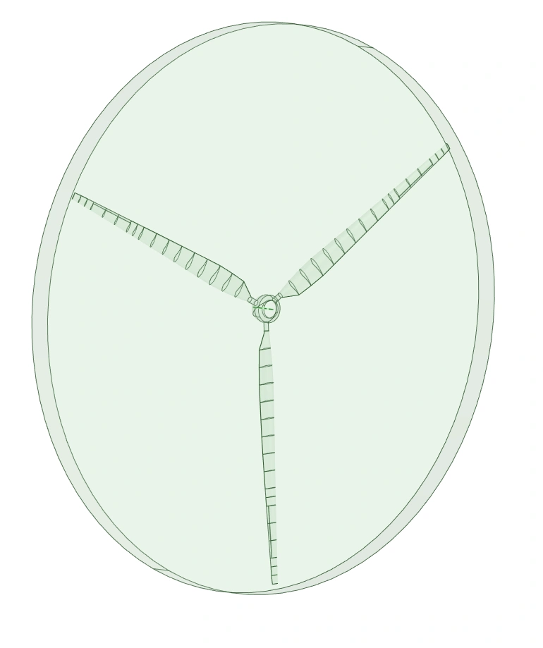

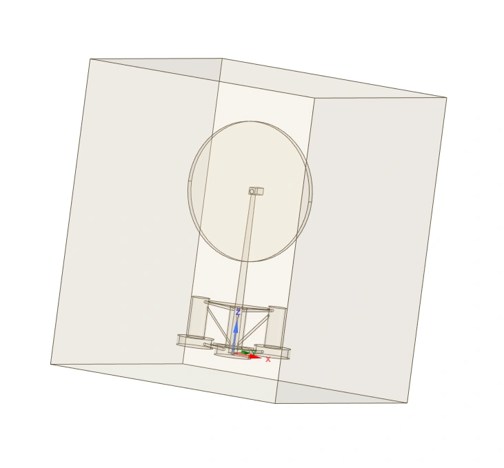

 The rotor area containing the blades is shown in Figure 1, and the outer cylindrical surface is set to interface. The rectangular area containing the foundation is shown in Figure 2, with its internal cylindrical surface corresponding to the rotor domain, which is also set to interface. The surface of the outer box is the surface of the overlapping area.
