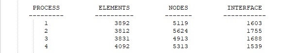

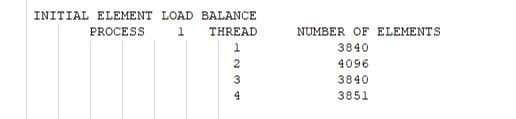

I notice that with default settings, the iterative solver uses thread based parallelization in newer Abaqus versions (v2019 and higher). I checked with my system Admin and they did not change the settings in environment files.
This however conflicts with what is mentioned in the Documentation. Has anyone else noticed this?
The following are excerpt from .msg files
v2017
v2020
