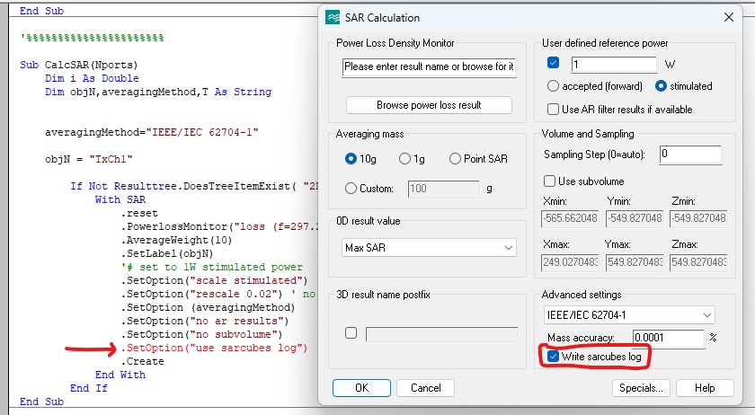

Hi everyone,
I want to export the SAR cubes log file from a simulation using the VBA macros.
In the Post Processing using the SAR Result Result Template one can activate the "write sarcubes log" (see attached image). This is what I want to do with the macro e.g. using .SetOption("write sarcubes log"). However, all the commands I tried do not work and the Help does not give information about that. Does anyone know if this is even possible using the macro and if so what the command is?
