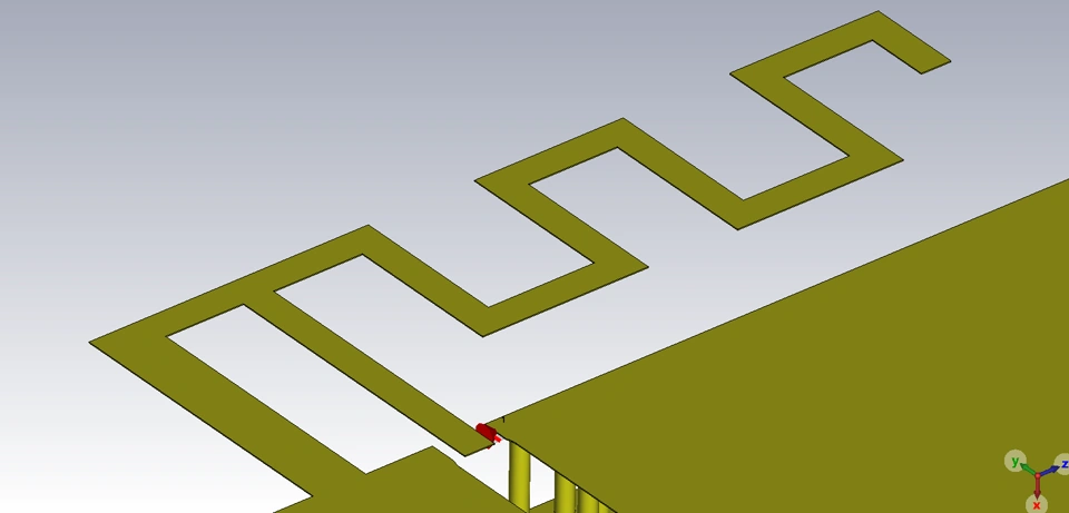

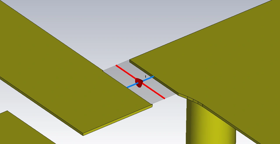

Hello,
I’d like to know if I’m correctly defining the port in CST for this Bluetooth antenna in order to view the radiation pattern. I’m placing the matching network in the schematic.

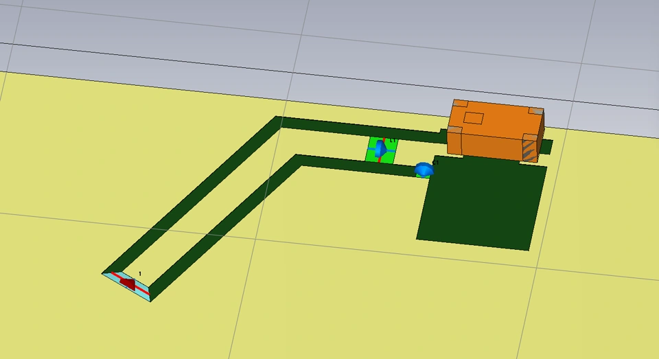

I’ve also seen it done this way. But it is not possible to define the matching in the schematic, so you need to run the simulationa gain if you want to put other values...
Which method is correct?
