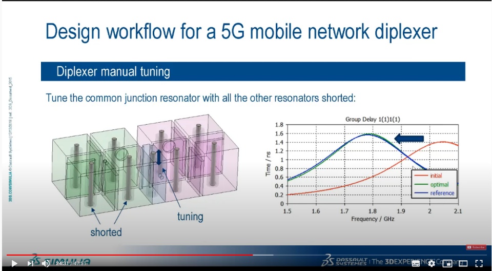

I'm following diplexer design process with important step is tuning junction resonator to achieve desired group delay response.
But I don't know how to get the reference group delay response of diplexer? Please show me how to get it ! I'm using FD3D tool in CST Studio Suite to support design process.
