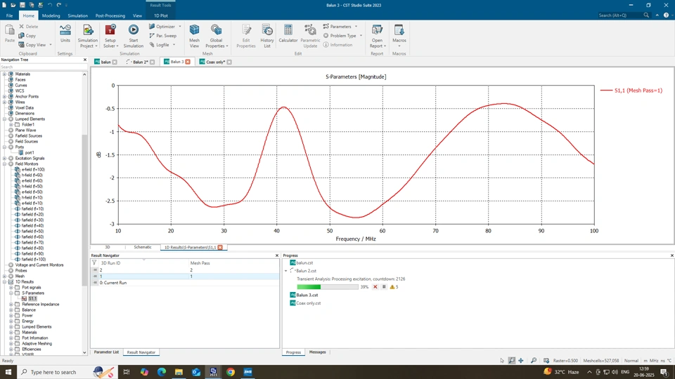

I am new to CST Studio Suite

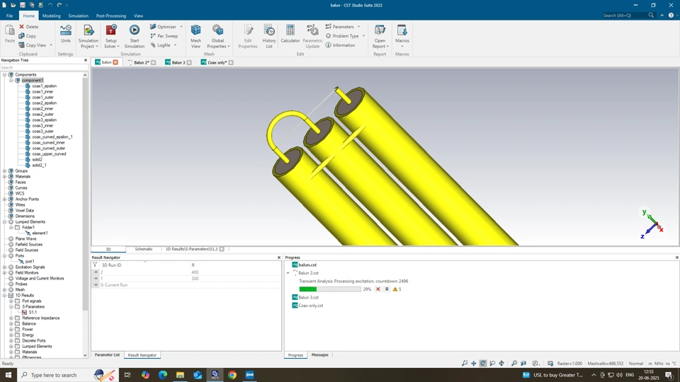

I am designing a folded dipole antenna and want to feed it using a coax cable.
So i tested the Folded dipole on its own using a discrete port to find its impedance and got it to be around 300 ohms
I have a coax cable of 75 ohms and want to match it with antenna using a 4:1 balun

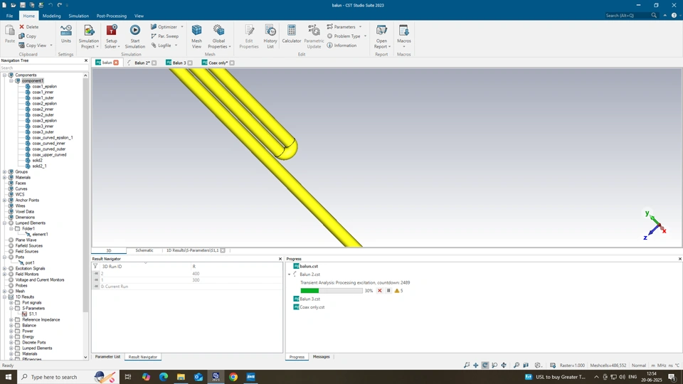

For that i have used a wavelength/2 coax.

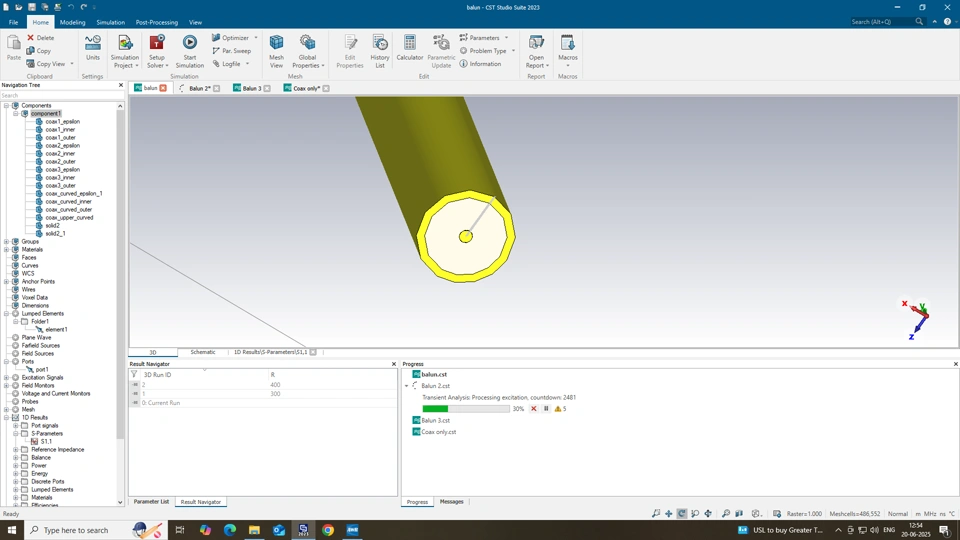

I have basically made this structure with appropriate diameters.
Since my target frequency is 60 Mhz my length of the bent section is around 1.25m on both sides.
So when i simulate it by connecting a resistance of 300 ohms as a lumped element across the the 2 terminals.

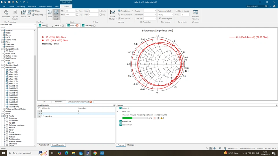

When i see the s11 of the balun it is very bad.
s11 does not reach below 3db
and there seems to be no resonance

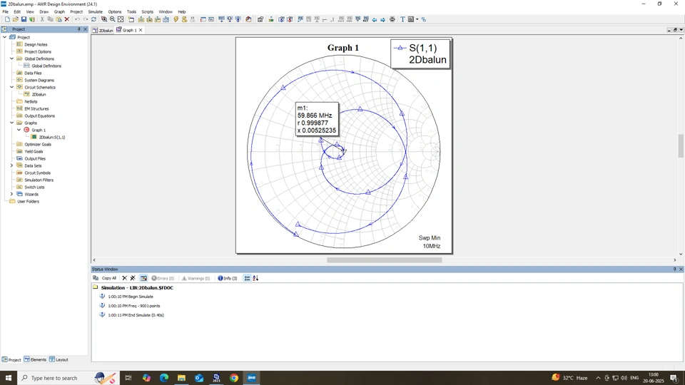

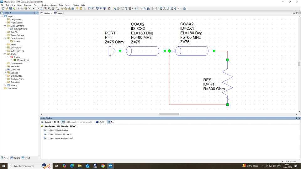

but when i simulate the same thing in cadence awr i get good results.
I get the normalized impedance close to 1. That means it converts 300 ohms to 75 ohms.
Can any of you help me with this. I can't seem to find what went wrong in this??
