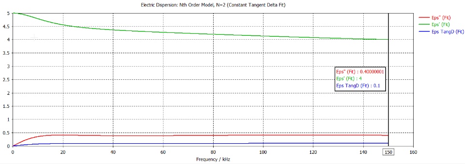

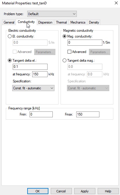

I just tried to add a new material with dominant tan delta to calculate a conductance at 150kHz with Electroquasistatic solver. Unfortunately however I choose tan delta, the conductance remains nearly nothing (about 1e-13). Whats the trick when defining a new material?
