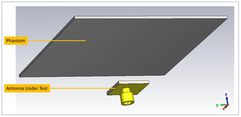

Does anyone know how to calculate Absorbed Power Density directly in CST without the need to process exported data in MATLAB?
The figure below illustrates my simulation setup, which consists of an Antenna Under Test (AuT) and a phantom. I currently calculate the Absorbed Power Density by exporting power flow data and processing it in MATLAB. In brief, I compute the APD based on the power on the surface of the phantom and average it over 1 cm² or 4 cm² areas.
