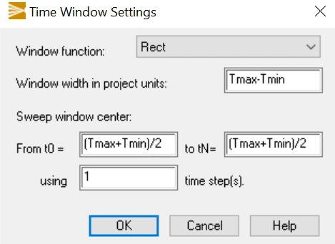

can anyone explain howto understand time window settings in General 1D-> Fourier Transform dialogue?
I am familiar with signal processing quite well, but cannot figure out how window parameters in CST Studio Suite  are used.
This is default look of the window. It does nothing useful. I have figured if I put:
t0=Tmin
tN=Tmax
it will generate time steps number of ffts. Help is total crap, does not explain at all how to parametrize this window.
Can anyone place few examples, howto use this windowing feature? I can obviously export everything to Matlab and do windowing, but it is not a point. I want to have all results in one program.
