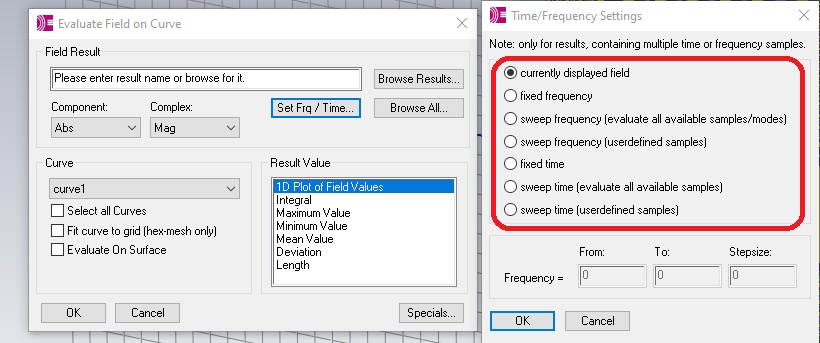

I would like to ask some help regarding the 3D field post-processing in CST EM Studio. I would like to analyze the induced eddy-currents in PCB tracks with the LF MQS/Fullwave solver. The simulation itself is ready, I got the 3D fields and evaluated them along a predefined curve.
Question 1: How can I select the phase of excitation/induced currents/voltages in post-processing templates (e.g. Evaluate Field on Curve)? (only frequency and time is available as option, phase is missing)
