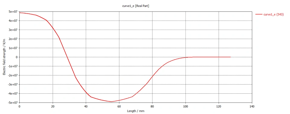

I have been using CST (2024) Eigenmode solver for a cavity optimization. I need the e-field data on curve like in the picture below.
In this curve we know the x axis is the structures length but I have no idea how CST calculates the y axis values. Because in eigenmode solver, we don't define any input signal amplitude, how can we know the e-field amplitude that is induced in the cavity?
