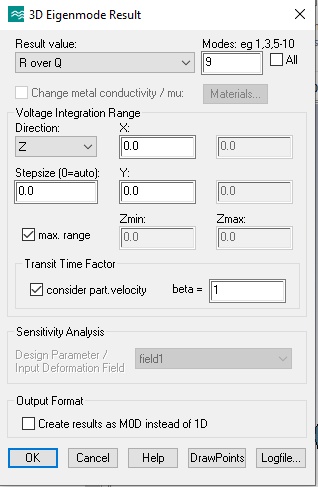

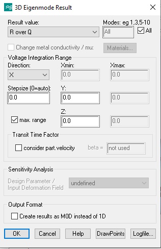

I am trying to import the displacement field map from MPhysics (structural) to MWS (eigensolver). When I did it by simply clicking on the field import in eigensolver, the field map was indeed imported but when I opened template-based postprocessing to calculate the R/Q0 of the deformed structure, the window in the template indicated there is no field map imported (see "undefined" under Sensitivity Analysis in the right figure ). However I acquired from somewhere the example where the field was indeed showing up in the postprocessing template (see "field1" in the left figure). Does anyone know how to make this happen? Should I have paid some special attention when I imported the field?
