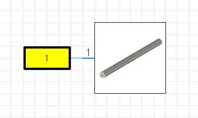

I'm trying to analyze a coaxial cable using the schematic interface in CST MWS and perform a TDR (Time Domain Reflectometry) analysis.

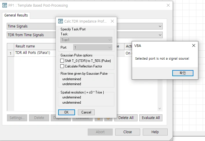

In the post-processing step, I selected "TDR from Time Signals" under the PP (Post-Processing) templates,
but I keep getting the error "Selected port is not a signal source."
In the 3D layout, I only used one waveguide port for excitation, and in the schematic, I assigned one external port.
However, the post-processing still complains that the port is not a signal source.
Interestingly, when I run "TDR from S-Parameters", I get results just fine.
Could you please help me understand what the issue might be?
