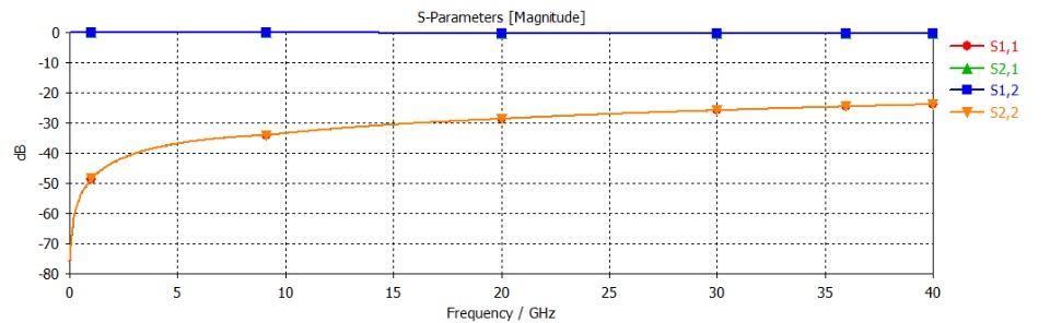

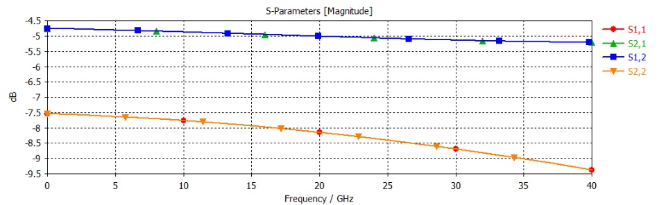

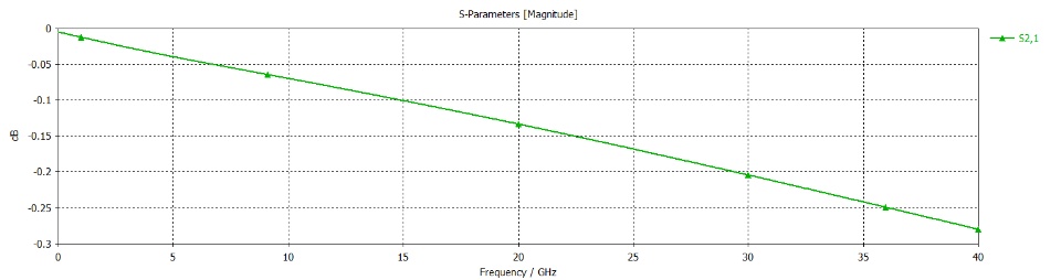

I am simulating an ungrounded coplanar waveguide (CPW) in CST Studio Suite 2022 with the time (attachment cpw_td) and frequency (attachment cpw_fd) domain solvers.
However, the resulting S parameters differ considerably between the two solvers (see images below).
Why is this? Which settings are wrong?
As I collected more experience with the frequency domain solver, I trust these results more.
Thanks.
CST Studio Suite ​​​​​​​
Frequency domain solver
Time domain solver
