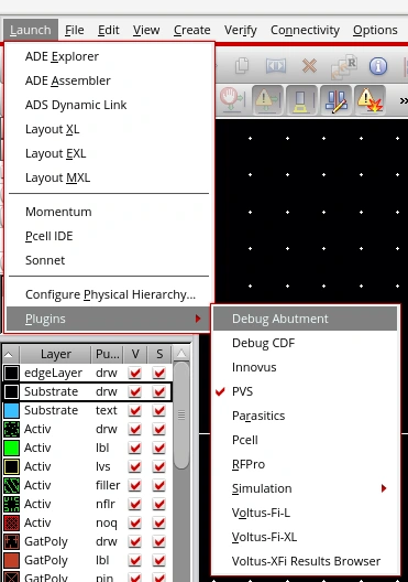

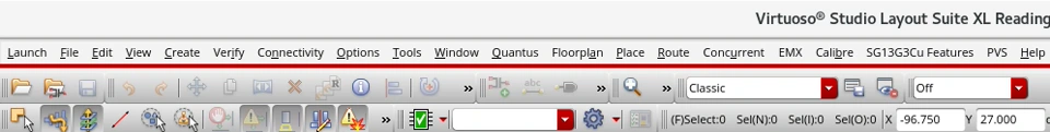

I installed the CST Studio Suite Chip Interface according to the readme-file. Unfortunately, the toolbar doesn't contain the "CST" menu nor does it appear in the Plugins menu.
Are there special requirements to the PDK?
I use Cadence Virtuoso Studio IC23.1 and LayoutX
In the Cadence log there is the following message:
Loading CST Virtuoso Link
Loading: /home/users/****/cst_virtuoso_interface/cst_link.ils
CST Plugin Version: 20190813
