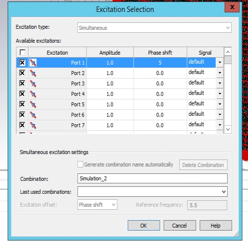

Hi,
I am simulating a 1,024-port array in CST Studio Suite  2021 Academic (MLFMM solver). To avoid a massive S-parameter loop, I must solve the array in a single pass using a Simultaneous Excitation. However, I cannot input my 1,024 custom phase values into the Excitation Selection table. Is there a UI workaround to force a bulk paste in this version, or can someone share the correct VBA API syntax to programmatically populate this excitation list?
