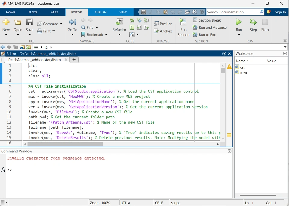

Recently, I attempted to use MATLAB R2024a to run a test code designed to invoke and control CST Studio Suite 2024. This resulted in an error message "Invalid character code sequence detected." consistently occurring. You can check my previous post.

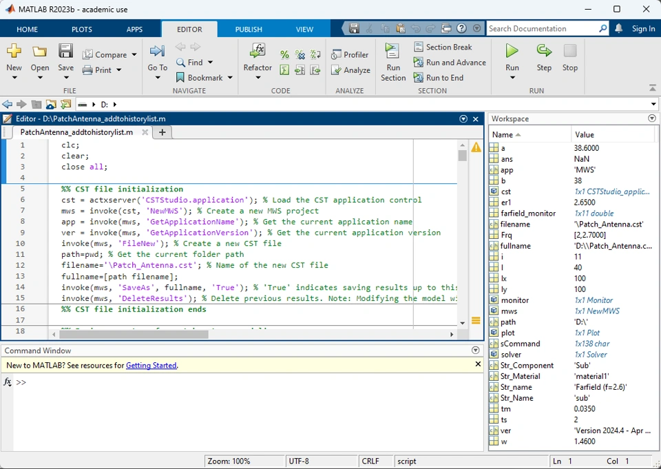

- I rolled back to MATLAB R2023b and used it to control CST Studio Suite 2023. This configuration worked without any errors, and the simulation in CST proceeded normally.
- I use MATLAB R2024a to open the same code to control CST Studio Suite 2023. This time that error happens again.

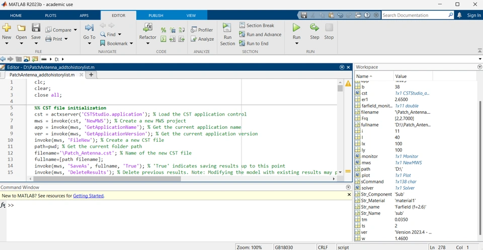

Finally, I use MATLAB R2023b to control CST Studio Suite 2024. The same code worked without any errors, and the simulation in CST proceeded normally.
