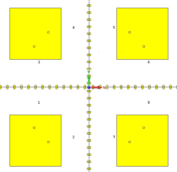

Hello,
I've designed a dual-pol patch element for a 28 GHz antenna array. Initially I followed the files attached in this post (found at the knowledge center). Now I have two next steps is firstly to find how/if it is possible to simulate a dual-polarized element that is rotated (see image) using the array task and if this is then easily integrable to an EM-Thermal coupling task.
The second point is clearly how to properly model thermally the chip being used (as I have a resistor model of it) and if this is easily integrable in a flow of Array task -> EM-thermal coupling. I would like to ask documentation on how to find out this.
Thank you in advance
