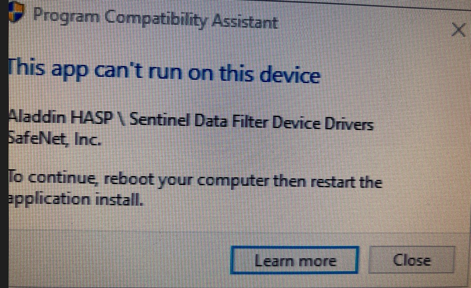

After installation of CST Studio Suite on a new Windows Server 2022 (Windows 11 gives the same result) a message pops up from the program compatibility assistant:
"This app can't run on this device
Aladdin HASP \\ Sentinel Data Filter Device Drivers SafeNet, Inc.
To continue, reboot your computer then restart the application install."
Few questions/comments:
1. CST still runs fine* when I fire it up (*please note point 4 in the list here though)
2. Did someone else have this issue and got advice from 3ds how to fix it?
3. It appear outside of this community people experience the same issue but no solution posted.
https://answers.microsoft.com/en-us/windows/forum/all/aladdin-hasp-sentinel-data-filter-device-drivers/9e836096-2980-4d57-ac20-f0c3a680618c
4. Since we got this computer several months ago we have had issues with sudden "Kernel Power Failure, Code 41" where the computer just crashes and boots back-up with no specific error other than that 41-code. It appear to be random times and stages in simulation every time (no idle crash). It was traced specifically to happen with a CST file where this happened over and over again, without the computer being heavily loaded etc. By removing this file, the computer is up and running simulations for several weeks in a row, but yet again sometimes crashes while running CST.
To the question: Can this be related to this driver/app issue windows complains about during installation (yes we have redone installation many times of both OS and CST and it happens again)?
Anybody with insight, thanks. I have also sent an email to my local support team.
