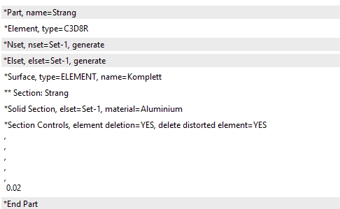

I have a question regarding the deletion of heavily distorted elements in Abaqus.

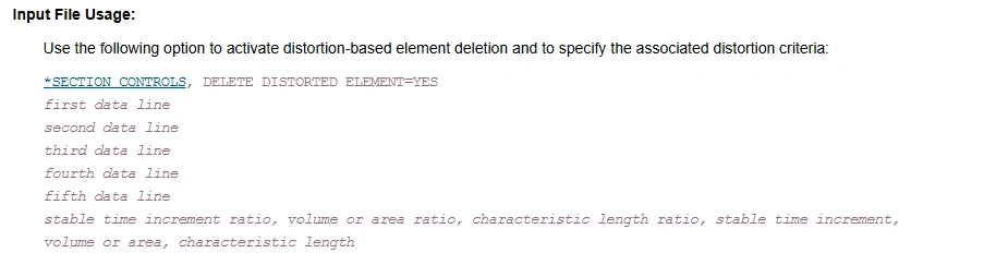

It is possible to insert the Distortion-Based Element Deletion in Abaqus/Explicit via the edit Keywords option.
Now I have two questions:
1. do I have to specify all parameters in the code or is it sufficient to delete the elements based on one parameter?
2. where do I have to write my code in the file?
So far I have used this place and then I always get the following error message
Error in job RISP_19_03_V1_01: in keyword *SECTIONCONTROLS, file "RISP_19_03_V1_01.inp", line 117186: The keyword is misplaced. It can be suboption for the following keyword(s)/level(s): model
Job RISP_19_03_V1_01: Analysis Input File Processor aborted due to errors.
